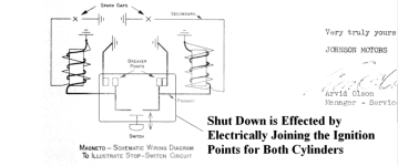

shutdown can bedone with the choke or install a "normal open" switch with wires hooked up to the points.
