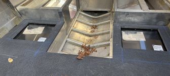

Installing the bulkhead around the step-down to the cabin.
I saw an opportunity to cram some more floatation foam in, so I took it.

SHSU
Lieutenant Junior+Starmada Splash Of The Year 2019
Mar 8, 2017
1,769
Very nice. Can't have enough foam. Something you want but hope you never need.
