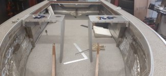

As of right now I have stripped it down to the hull and foam. Amazingly the foam was in great shape and therefore left in place. It had no foam up under the bow so some was added as was some added behind the hull access. Still plenty of area for water to make it to the stern bilge pump in a hurry if I ever take that sort of wave.
The new 1/2" marine ply was cut to size using what I could of the old floor as templates. I then coated the ply with 3 coats of epoxy paint on all sides. 20200906_182351.jpg20200913_154902.jpg20200913_170340.jpg

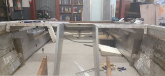

As it sits now flooring is 90% secured down will pick up more fasteners tomorrow.

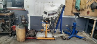

Top of gunwales has new vinyl layed...then I decided to pull the motor to paint the splash well....then I decided to pull the transom and replace the wood. (Backwards I know)

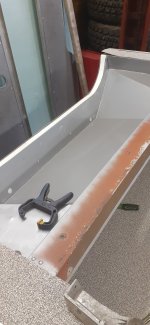

The consoles being angled to the sea side drove me nuts as everything wanted to make it's way overboard so I am reworking the consoles to make them sit level. Quick easy project.
Already plan to replace the dash wood as well as the wood in front of the console so I might as well.
Now when the boat is done and back in the water all of the wood will be new. Good for another 30+ years.20201108_203244.jpg

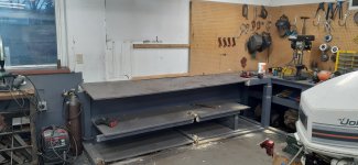

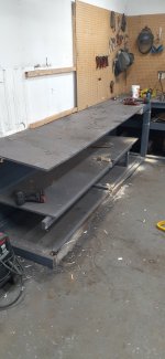

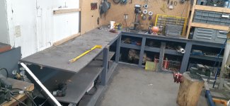

Well I've been busy working away in the garage, unfortunately I got sidetracked and revamped things a bit. Rem ou ving 9' of workbenche. Garage had 36' total
I did purchase the needed 3/4 marine ply for the transom and got it cut to rough size. Also picked up more epoxy and 1/2 marine ply for the gunwale storage area.
Slowly but surely.
Tonight i moved the stereo system in the garage to round out the revamp. Just some final cleanup
