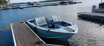

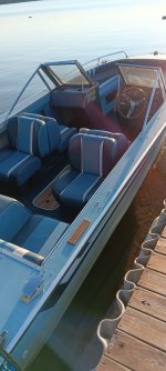

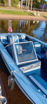

So I bought the boat last year. It's an 18' aluminum with a 2.5l I/O mercruiser. Runs fine and is mechanically sound. Started with a 17p prop and I could get it to 4k RPM. If I trim any higher it starts porpoising. Tag on the motor says WOT is 3900- 4300 rpm, but I read that the spec was changed that same year to 4200- 4600 rpm, so I figured I drop to a 15p. That made it worse. At WOT it's porpoising at about 3600 as I trim up. Should I try the opposite and go up to a 19p? I can live with a max of 4,000 but I also don't want to lug the motor. Thoughts anyone? P.S. the boat has not been modified an any way and it's just me in it when I run the tests. Both props I used were aluminum, also there is no rot or waterlogged wood. Thank you.
