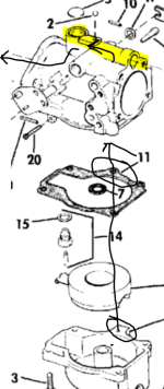

idling on all these oldies from cd fd qd etc...relies on drawing (sucking) fuel from the lower carb bowl via a very narrow side channel. Your carb model uses a air "orifice plug" instead of the old easy to adjust pointy needles.
Fuel reaches the top of the carb and drips out 3 small holes with the throttle plate closed. If the plate is not closed properly suction of the necessary "idling" fuel supply deminishes as the crankcase vacum now " tries" unsuccesfully to draw fuel from the high speed fuel supply from the carb bowl center post.
Compression is excellent, you have sparks so getting fuel into the cyl seems to be the missing element. Sucking fuel from the carbs needs good vacum from the crankcase during piston up strokes. If for some reason other than throttle plate not closing properly vacum could be lost due to bad crankcase seals alowing air to be sucked in instead to the fuel from the carbs. (see tube from Danbar marine).
Hopefully not the case ( see Danbar marine utube) .
Has suggested by McTool cleaning the carb may require poking out the side channel path up to the upper drip chamber under the round dime size plug ( which can be removed for inspection... and replaced.)
Carburator concept and operation is well detailled in the Johnson service bible ( see carb section) you can download free. Old stuff but concepts are good for your " modern" 1983 carbs
