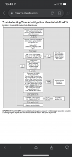

Would either of y’all happen to know a part # for the ignition sensor? I’ve tried to find it but couldn’t come up with anything. I will attach a picture of what mine looks like.

Run through the diagnostic flow chart before you start throwing parts at it.
