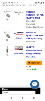

3,212
If it's a 96 then your original plugs are correct and they are still available.
BowPro
Apr 25, 2012
75
I got the Model and Serial and its a 1996. Yes Sir, the plugs in it were what it called for. Every local part store in my town said they had to special order them. I found this site and it shows an NGK cross reference and recommends them over the Champion. "EVINRUDE/JOHNSON MOTORS SHIP WITH CHAMPION SPARK PLUGS. WE RECOMMEND NGK INSTEAD, AND TRADITIONAL ELECTRODE-GAP RATHER THAN SURFACE-GAP PLUGS WHERE POSSIBLE. WE HAVE FOUND THAT THE SURFACE-GAP PLUGS, WHILE LASTING LONGER, SEEM TO HAVE A SLIGHT PERFORMANCE HIT OVER THE STANDARD PLUGS." My part store has the NGK's in stock..yaaay.lol. Here is the link to the site that I just quoted from if anyone finds it handy....
