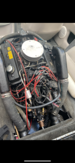

^^^this is what I am thinking too. I would almost bet that if we can get the radio to work the boat will start. I am not familiar with the engine though ive been on the boat lotsof times. it's always run well...
does anyone know where the ecm/fuse box. any breakers are on a 1994 MC PS190 with the the "normal" engine ? (not sure its indmar after all)
I will try to post a picture. it has the round air filter top center and a distributor cap with wires coming out the top (not sides) behind that. no plastic cover like newer motors.

Bottom right in your pic is where the engine connector is. Also would think that is where the breaker is.
Don't know if Indmar uses a 90 amp fuse on the starter post, but if it does that might be it. Looks like a cube
