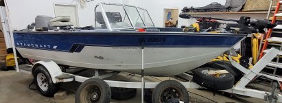

I appreciate what everyone has said. Does any one have pictures or a thread that can give me an order to do it in?
Also, here is a picture of the boat.
6,376
Might be better to show the problem areas themselves. Nice looking boat, that hull style handles chop well.
