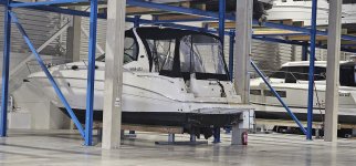

End of the shittiest season finally arrived - last few days went for testing under load and all seatrials did not show any differences between engines. I have a feeling that despite the fact that everything was changed between the engines, issue still relies with water flow. Noticed that there was a lot more air after 3800 rpm drive on the faulty side pipes AND water pressure is lower on that side as well. As sensor was swapped and pumps as well without any major change, there has to be some blockage somewhere.
That will be the winter project now.
Here is the run with WOT
Bubbles in the hoses
and liftoff...

Will start the "pipe dismantling" project in November to see, if there are something inside the pipes or water chanelles, also will check that water inlet is clean - filter was and water is flowing, but something somewhere most block the flow. Anyway - IF I will reach to some conclusion, will let you know here as well.
