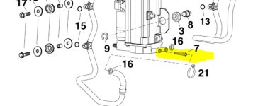

one sneaky critter is the VST conical filter not shown on 2005 diagrams.....
it can be clogged from soft fuel line debris with age and the EMM would not know.
VST nipples are very easy to crack PROCEED WITH CAUTION if you plan to inspect this $2 part which blocks fuel flow returning from the injectors !!
