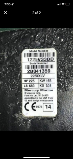

Can someone help me with this motor? Are they reliable motors? Do they come with remote control controls or do I need cables? Is this a two stroke or four stroke?

1)Are they reliable motors?...If they have been took care of as maintenance is higher on these
2) Do they come with remote control controls or do I need cables?...Have to purchase DTS controls if not supplied
3)Is this a two stroke or four stroke?...Supercharged 4 stroke and not every Merc dealer can work on them

Thanks! What type of maintenance requirements do they have
Less than an I/O…
Change oil (motor and LU) and filters annually.
Having said that, not a fan.
Rather “doggie” for a 225 HP outboard. Much prefer a 6 cylinder
If you do get it. Keep an eye on the heat exchanger.
