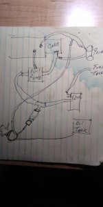

OK well I guess I was just frustrated and it's not so complicated once I drew it out. The problem started with a deteriorated pick up hose in the fuel tank and we all know what that does. So I replaced the hose, flushed all the lines, cleaned all the crap from the fuel filter, replaced the fuel pump because I didn't want to take it apart, unclogged the check valve between fuel filter and oil pump, cleaned the carb and unstuck the float and (fingers crossed) it seeeeeems OK now. Attached find my sophomoric fuel system diagram.
