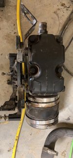

My first boat rebuild... this all started w a “hole patch”.... which I’m sure some of you might be able to relate. After realizing the floor needed to all be completely redone, I found JB weld all over the block & manifold.. so new engine it was, bought a SBC 350... also painted it, anxious to hear it in the boat now.. ANYWAYS, part of the reason for this post is I ran across some parts for sale & would love to find some help in regards to what route to go with things... because I am getting ready to purchase what parts I need & I would also LOVE to have a little extra performance and rumble to be honest.. I just may be able to get a decent deal w these parts, which then I could spend that difference and then sole hopefully on doing everything I can semi cost-effectively while I am in there now.. I am basically trying to get as much prepped & ready as possible.. I did add SOME photos for what has been done currently and also will add photos of the parts for sale ad, am supposed to reach out to him here this afternoon/tomorrow afternoon. I will also add below:
•The list of what I have wrote down currently of what I was told that I will be needing.
•Also, a handwritten note on questions of what parts might help me..? Which are basically all guesses for the most part...
I do not have a ton of experience of physically working on engines until now.. I do part-way understand how most things work.. I have already bought the exhaust manifolds & thinking I may need new risers as well(on for sale ad, why I am part-way interested). I will attach pictures of my old risers as well so that my help can have an idea on where I am at..
(PARTS LIST): I currently have down that I will need:
•I did buy some exhaust
•Already bought a pair of exhaust manifolds(factory basically, but would have considered better ones if I would have known prior the difference better ones would have possibly made).

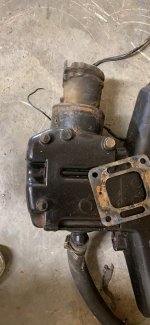

•I am interested in some new risers because mine are a little rough(pic attached) and also i have heard a lot on how much the risers can help with performance..? I can see that on the pricing as well... lol but risers are on the parts for sale list, along w many others: which is where a lot of my handwritten questions marks came from.. I will also attach my Engine Specs as well.
•The parts for sale list also has a a single holler double pump 750 CF carb better than my original carb(pictured in attachments) if I rebuilt it?
•oil sending unit(SBC350)
•oil filter
•fuel pump
•fuel filter

If your old exhaust is fresh water, more then likely their fine. Headers will do you no good because you do not have enough power to make them a benifit. Now if you went to aluminum manifolds and stainless risers, then there is a weight reduction which would help

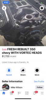

Started with a “floor patch”.. then found a jb welded block.. pulled engine and bought a new one. Engine builder I got it from said the cam would be fine for a boat

Cam duration and lobe separation are important for a marine engine, because of the 'wet' exhaust. Less 'duration' and more 'separation' are good things for a marine engine.
Google 'exhaust reversion' for more details. Essentially, at the top of the exhaust stroke, both exhaust and intake valves are open with high-performance cams (even many automotive cams). The exhaust is under pressure and the intake is under vacuum. So . . . . a slight reversal of flow happens, particularly at idle speeds.
In a car - this reversal is no problem. In a boat engine - water mixes with the exhaust at the end of the riser/elbow for cooling. A reversal of flow may/will cause the water to be pulled into the exhaust manifold (where it should not be). At that point water can be pulled into the combustion chambers and cause a hydro-lock. :oops: 🤪
