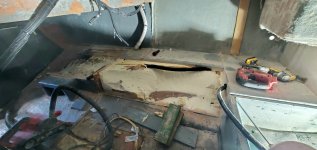

In my situation I'd prefer to leave the cap on and mask off areas where I won't be working. The boat is outside and the cap gives me some protection from the sun. I can also store my tools in the bow when I'm done for the day. I'm almost done grinding out the wood in the transom; the wood carving disc and 40 grit flap wheel worked great! I'm going to pick up a sheet of 1/2 & 3/4 inch Coosa Bluewater 26 to glue to the transom skin.

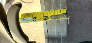

I'm already at 2 1/8" without glass and the core not bonded, that only gives me a 1/8 of an inch to work with. I'm cutting it close. I might run the belt sander across the transom a few times to give me some wiggle room.

Do the 'burn an inch' technique to get a more exact measurement, but generally you want the core to have been 1.5" . . . looks like you are at 1.75"

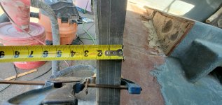

I mentioned before that the tansom skin was thicker at the bottom half of the key hole. I used the belt sander with 36 grit and brought the skin down to 1/4 inch all the way around the key hole. There seemed to be a large buildup of CSM around that area. A straight edge would rock across the hole, and now its fairly flat after sanding. I figure with the stack up I have planned it will be 1/4" for outer skin, 1/8" for glue, 1 3/4" for core, and 1/8" for inside skin. If it all goes to plan it the transom will end up at 2 and 1/4" thick.

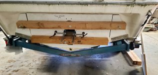

Well, I've decided to use thickened epoxy to bed the transom. The bad part is, I will have to baby sit the job with a rag and acetone to clean up the squish out. The reason I'm cleaning it out is because I want to fillet and lay glass with vinyl ester resin. I am working on the clamping setup setup now so I'm not fumbling around while the epoxy is curing. This is a picture of my setup. I did not drill any new holes through the transom.
