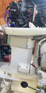

I added the pic of the lower unit. I did not change the rod height after replacing the impeller
