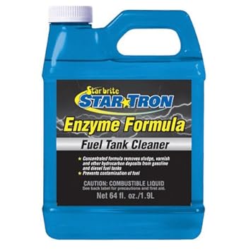

Before cleaning I would pressure test the tank to be sure there aren't any holes. If no holes then move on to cleaning.If there are holes you'll need to repair them if they're not too bad. I would use Star Tron fuel tank cleaner.
