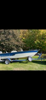

I found this old thread,
But I'd like to see more pictures of ones on the bow of a StarCraft.
Also, what size thrust with size boat do you have, and how's it been working for you?
Oh, and what length shaft do you have?
Thanks.

I ask about the shaft length because my 18 foot Holiday sits up high out of the water.

Super fisherman with a 60” shaft. 45lb.
I took it off because it was broken and it is really hard to see over the bow.
The high bow boats aren’t very good for bow mounts. Hard to see over and the high hull catches a lot of wind.
I tried a 30 lb thrust on the stern and that wouldn’t push the boat.
So I bought a 5hp kicker. I’m running it without a bow mount for now.

I know I should know, but I'm going to take my boat out today just to put it in the water to take a measurement to the water line at the bow.
I may be surprised, but I'm thinking for semi rough water, I'm going to need 60 inches to keep the lower unit submerged.
I'll post back.
Berdink
Mar 5, 2020
277
I took my boat to the river.
It's 35 inches from the top of the bow surface to the water.
