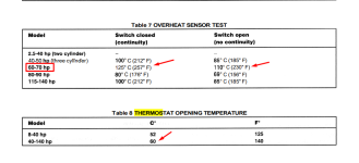

Overheat sensor is bimetal I think this model:
New Genuine OEM TOHATSU OVER-HEAT SENSOR ASS'Y 3F3761720 3F3-76172-0 60 70 HP
I know it is strange, but that is chart (in picture), for my Tohatsu 2-stroke. So, you say, that my outbard is overheating (closing the sensor = trigger alarm).

That table is very strange, but just for your motor. The rest of the entries looked about what you would expect.
Even if the coolant water was pressurized to 7lbs, like an automobile, the coolant water would still boil, before the sensor closed.
I am hoping the table is wrong.
You said you tested the sensor. How did you get the water to become 257*F? You would have needed to test it in oil, with a candy thermometer. Hopefully wifey didn't find out..

I tested in closed room with hot air on low with SMD rework station and using Digital thermometar to take a measure. I set SMD station compressor to low airflow, temp on 150'C (300F) (can set from 150-400'c) to heat it slowly from a short distance, and I think that meassrment I get are good. I try 5x. It close at 125'c and open again at 85'c (when I slowly turn airfow to lowest)
The Table is from owners manual, and I checked on other languages, it is same. Also checked in the Service manual for all 2-strokes 3 cylinder (60-70hp) and the temps are unreal.
