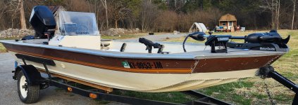

2003 50 ELPTO, serial # 0T681654, new to me. Bought it last January, used it a few times this past summer. Fixing issues now that its cold. I have been advised to rebuild the carbs and treat it with Seafoam, preparing to do that while fixing other things. Part # for the kit I found is 1395-82365 4. Best price I have found is at WholesaleMarine.com ~$54 but I also found the Sierra Marine equivalent for $35 (part # 18-7750-1). Which would you use and why? Is it worth the extra $60 all three carbs or is the Sierra Marine a good product?
