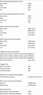

I tested everything again with a different meter using cranking speed instead of idle speed, and all seems to be more or less in spec according to the CDI sheet. Not sure why I was getting a weird resistance on the red wire originally.
There's no mention of testing the bias circuit, however I've read that I should have > 1V on the black-white wire at cranking speed, which I do at first, but it does drop half a volt white continuing to crank. Not sure if this is indicative of bad pack(s).
I popped off the flywheel and I don't see anything melting, dripping, binding etc.
Aside from throwing another stator at it, I'm not sure what else to do to.

Doubt stator will fix it...
You were correct - I left the stator in place and instead replaced both switch boxes. I now have spark on all cyls over 3K RPM. The boxes were suspicously cheap but appear to be working for the moment. Thank you sir!
