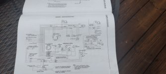

Would like to get a wiring diagram for a 1985 Chris Craft Scorpion. Any help would be appreciated! Thanks

Had an old clymer manual here's a picture of it. Hope it helps...

90% of the engine / helm gauges and such are available in the Mercruiser manuals.
Chris Craft specific wiring would be the unicorn info, but normally done to AYC stds for color codes, breaker sizes and wire sizes.

Yes that's the book I used working on a 79 model I had. If the op is more specific this book has additional schematics ..
