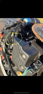

starting a new thread because I think it’s a new issue. Model number and pics for reference posted below
I have. 2001 evinrude that just got a new/used power head installed. Ran great before connecting it.
Took it to the boat ramp it started and I got it to the dock to park my car turned it off and when I came back to crank it I kept blowing the fuse going to the PDP at key on. Found it was a loose wire to the pdp and then it now cranks again. I charged the batteries up, they’re brand new. And it just continually cranks. The rpm gauge flips in circles which was weird. In desperation mode I used starter fluid and it still only cranks without turning over.
Any ideas appreciated
Spark plugs are good
Batteries are good
Fuel should be good but I’m thinking maybe there is some bad fuel in the carb or cylinders if it is bad
Please help. This engine is just a nightmare and I’m just trying to get some bluefin tuna this season 😂

Ok hooked up a jumper and it ran. Noticed positive terminal is pretty corroded. Going to try cleaning that off and seeing if it is going to end up being a quick fix
