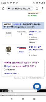

Here is two numbers for your carb.....maybe someone put the wrong carb on it.
