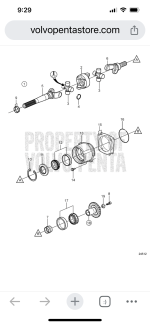

So the snap ring 10 holds that in place? Haven’t found that yet. Time to tear it open. 11 is the seal which you can see in the pics above are junk. Hoping I can maybe get a new seal and snap ring and hopefully the bearing and gears aren’t junk… highly unlikely I know.

It does look like they changed from a retaining bolt to a snap ring.

So the bearing is gone. Snap ring goes on the inside lip of the carrier housing and holds seals/bearings in place.
The yoke is indeed held into place with a washer and bolt which obviously sheared off.
