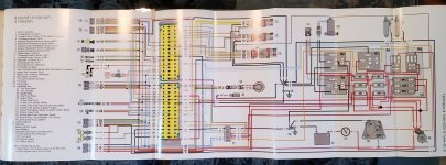

I ordered some Volvo Penta manuals and wiring diagrams.
Interesting stuff.
What I find most interesting is pin #25 and pin #26 on my ECU... Apparently the ECU gets a separate signal directly from the tach.
I find it odd that it uses a tach signal when it already has cam and crank sensor inputs (which drive the tach)... and appears that it only throws a code if they are shorted, not when they are open... so if those wires were cut, the ECU would not know how fast the engine is spinning... yet the tach would still function ?
Interesting stuff.
Do you have any wires connected to pins #25 and #26? Based on the screenshots you posted, these pins aren’t used in this application. I’m just guessing here about those pins. But that circuit is probably there to provide the option for cruise control.
The last 2 screenshots deal with the tach output. This is a single wire that goes to the tachometer. It’s monitored for shorts to ground and positive because those 2 failure modes might affect some of the other circuits in the ECM. In this application it isn’t monitored for an open because that won’t affect anything other then a tach that doesn’t work and you’ll be able to see that without a scanner.
I highly recommend you get Diacom. When you order this from Rinda, tell them you have a Volvo and they will usually include some of the service literature and that might have a copy of the school handbook we get in class that will help you understand how this system works.
Pin #58 is "tach output" which is where it throws me off... as this should be the signal telling the tach needle where to point.
Pins #25 and #26 are "speed pos and neg" which I *think* is voltage returning to the ECU from the tach. Only reason I think this is because of the statement in the very last screenshot that says:
"The ECM monitors the amount of voltage coming from the tachometer and sets DTC 2618 (or 2619) if the voltage is outside the set parameters"
I will hop in the boat tonight and confirm wires or not on those two pins.
And yes... I think it's time to buy Diacom software and better familiarize myself with the system while everything still works properly and before I have a failure of some kind, like the knock sensor in that other recent thread. Do you sell this software by chance ?

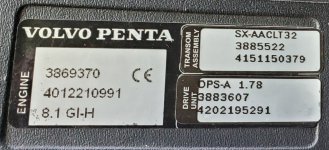

This is what I have:

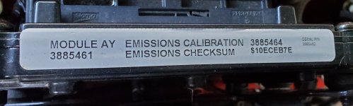

This is the GXI ECM: (I dont have a serial number to go with it)

Volvo tech support can decode those ECM #s.
That's kind of a typo in the manual. It isn't there in later manuals. It doesn't really monitor voltage except for shorts to ground or positive. We use a Hz meter when troubleshooting this wire.
