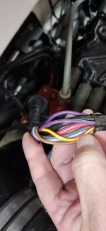

After looking at the main harness on the boat side, I have discovered there are only 8 wires instead of 10. The tan/black wire is not there, leading me to believe there never was an alarm on the boat. Guess I'm going to have to tap into the engine wiring harness, and run a wire to the helm.

So, no obvious prior alarm, got it.
However, something still seems off and I am not experienced enough to understand why. I looked thru my manual and there is no schematic with only 8 wires into the plug. All had 10. And none with a Purple/White wire. And your picture sure looks like the correct connector. For giggles I did a side by compare, see pictures below.
What to make of this? I do not know. Hopefully others will. And be careful tapping into wires to make an alarm to preclude harming the MEFI unit.

Great you got a working alarm but this does leave me confused. The 10 Pin connector has on your boat only 8 wires per post no. 4, and the Tan /Black at pin 4 was not one of them, i.e. I understood Pin 4 to be ‘blank’. What is going on?

The engine side of the main harness has all the correct wires, however the boat side has only 8. From what I'm reading online, Four Winns offered the engine alarm as an available option. Why it would not have been standard is beyond me.

Ah, got it. I confused post 4 as the engine wiring harness which really threw me. I need to think more broadly next time ;-)
Merc and VP offered alarms mounted on the motor and under the helm. The problem comes in from VP going their own direction and would not always put alarm on the motor. The standard harness uses the 10 pin connector but just uses 8 wires. Merc uses pin 4 (tan/blue) for the alarm, VP used same pin but (Tan/Black) but then later changed things.
