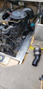

I removed mercruiser 3.0L motor and outdrive to have transom welded where it meets the bottom by drain plug.

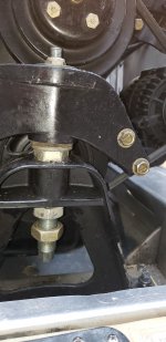

Re installed motor and cannot get it aligned. I did not move the nuts on the front mount which is down all the way.
If I loosen the rear mount bolts I can almost get it right.
My question is can the rear mount lock washer or springs get worn out and make the rear sit too low?
Picture of front mount adjusted all the way down.
Picture of motor.

Well I have the front mount as low as it will go. I got the gimble bearing moving on axis. The best I could get was spline marks all way around on tool except 3 on the bottom at 6 o'clock. You can't rotate tool with 2 fingers. You can move with one hand. I checked alignment at 12,3 6,and 9 o'clock. No change. All the same.
I hope this is good enough.

I have had to remove the front mount and have a welding shop cut 1” out of the aluminum lower mount and re weld it to finally get the alignment correct.

What causes the front mount to be too short? My best guess is a rotten transom that allows the transom plate to shift downwards.

The mount is to high. It is adjusted as low as I can go. Its an aluminum boat. No wood. Mount sits on a SS saddle bracket the spans the two main aluminum stringers.

You might get by if you remove the top nut on the mount, that worked for me a few times. If it is too low then you can shim under the mount on the cross brace.
Or just go ahead and have the mount cut and re welded.

Its a Fisher 19ft Sport Avenger. I am going for a sea trial tonight to see how she runs. Been 7 years since she has been in the water. Then I will look into modifying the front black engine mount.
