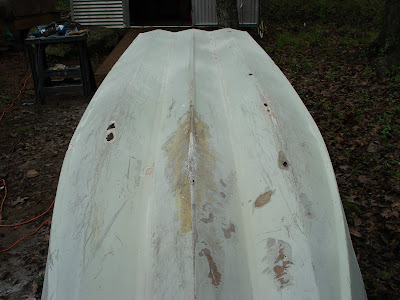

I just started pressure washer sandblasting the multiple layers of bottom paint off of my 1969 Boston Whaler. What I have found has been less than satisfying. I was hoping to wetsand and buff the bottom, but it appears the gelcoat is too far gone for that. I guess the idea now is to fill and re-bottom paint the boat as it will be on a trailer. The good news is I weighed the hull and it is not waterlogged one bit. I didn't capture a photo of it, but in some places there are divots in the fiberglass around 1/8" in diameter, are these blisters?
Should I fill all these cracks and voids in the gelcoat with a material like the Evercoat Gel Paste?
What are my other options?
The boat will be on a trailer, so it doesn't need "real" bottom paint, what is good for painting the bottom of the boat that is a little less toxic?
In the very bottom middle of this image, you can see some divots.
