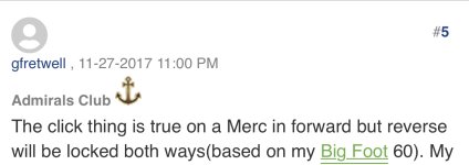

The dilemma I have is that Mercurys supposedly do not spin in either direction when in reverse and only ratchet in forward when spinning it clockwise. I don't want to take it out again if i don't have to, and at the same time need to if it isn't right
According to who? Should ratchet ccw in reverse
5,346
Information referenced in post #5 is in regards to a mercury outboard not an alpha sterndrive.
Outboard clutches often times have square lugs for reverse engagement thus not ratcheting in reverse gear.
Mercruiser alpha style clutch dogs have for many many years contained ramped teeth for both forward and reverse gear engagement. This allows for the clutch to disengage smoother/easier when shifted to neutral
If your alpha drive clutch does not ratchet when rotating the propshaft ccw when in reverse gear either the shift cable/linkage is misadjusted or there is an issue in the gear case assembly
