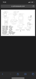

These are the relays I picked up, see attached picture of the manual. Does it look like the right gear for the job?

Yeah they'll work, but they don't appear to have a diode I mentioned above.
You're driving the relay with a mechanical switch, worst case w/o the diode, it could shorten the switches life some by arcing HOWEVER that circuit is most likely isolated from the rest of anything that might have issues, so its not too critical.
