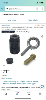

Also another quick question. My boat and motor (1987 force 85) currently have power trim. The motor I’m looking to buy (88 force 85) has no controls with it including the trim. Should I expect to have any mating issues when I do the motor swap—obviously I’d like to keep the trim system on the boat.
Also, I bought this from Amazon to lift the motors. Have people had good success with using this?
Thanks
Jiggz
Oct 23, 2009
3,909
Unfortunately, the flywheel lift kit you bought does not fit your 85HP motor. The kit you bought will fit those smaller and older Force/Mercury motors with threaded center flywheels. The later models and larger HP motors don't have threaded center flywheel instead has three bolt holes for removing the flywheel. The same holes can also be used to lift the motor. Just make sure you use high grade bolts, i.e. Grade 5 or 8. There's however a special tool to lift the powerhead which threads to the crankshaft end but I doubt it's still available. Flywheel Puller Type.jpg

I made my own using an L bracket.
Get a BIG L bracket , drill out the top hole so a heavier bolt can be used.
Then mount it using a 1/4-20 bolt.
The 1/4-20 is a bit light but will work, or drill and tap to 5/16 .
