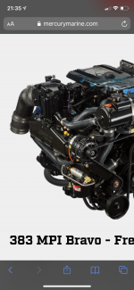

Bought a new closed cooling 383 mercruiser stroker with the single point drain. However can not figure out if the exhaust risers need draining. I have poured through the manual and interwebz but nothing specifically calls out draining the risers. Ive opened the drain plugs and emptied the raw side of the heat exchanger but want to avoid freeze damage to the risers. Help?

Engine part number 8M0136295 comes with Factory Fresh Water Cooling System that protects the engine block and exhaust manifolds.
So with that the risers are raw water cooled only and if you live in an area that gets pretty below freezing often and for long periods of time, your safest bet would be to address the risers of ensuring the water gets out and consider adding some marine winter grade antifreeze for added protection as the gasket between the riser and manifold is fully blocked off....Water on top, antifreeze below...
I'd probably say that In this/your case due to engine model, adding some antifreeze to the top side of the gasket area of the riser ought to help make you sleep better on those colder nights. :)
See the 2 notes for item # 12, https://www.mercruiserparts.com/bam/subassembly/32008/16414/170
Here's your parts guide for your engine serial number for future use if needed, https://www.mercruiserparts.com/383-mag-stroker-bravo-1g400000-up
Your engine details,
Hope this helps, good luck.
