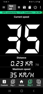

Not much difference with Evinrude 15. Boat 15.5 feet, 190 kg

Yes, Johnson is 2000 and Evinrude 1992, OMC went from 13.2 to 15.6 cu in 1993. Question concerns horse power which could be same 11.2 kW (15 hp) in both. I haven't compared the carburetors, if Johnson has a smaller throat carb (9.9 HP) or not. If it does, extra power comes from somewhere else (jets?) Speed was roughly same or both motors.
