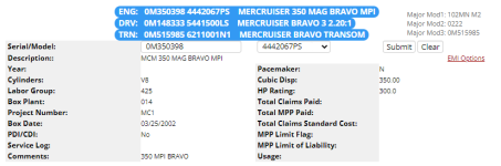

Hi. Maybe I’m not reading this right. Have you the bravo 3 with twin props and both props are 4 bladed ?
Why ratio do you have ? Is it the normal 2-1 or close ?
When you say it’s the 350 efi…do you mean the mpi rather ? Big difference in power between the efi and mpi. Different rpm range too.
zul
Aug 24, 2015
235
It is MPI. Sorry, I listed that wrong.
No worries. You’re certainly lots down on pitch from that maxum I knew. But you may be at altitude perhaps. The 4 blades won’t be helping your performance top end at all though. That’s not the props it would have came with. Would have been twin 3 blade merc stainless props. Likely about 24-26” all things normal
