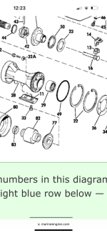

Hey. So I removed and reinstalled made sure the pin went in on the shift rod casing so it's home as you say. But still getting no alignment. The forward gear seems to be too much forward to make room for pinion to align properly. I followed a diagram guide how to properly put together the shift rod assembly, forward gear and clutch dog onto the prop shaft so it should be correct. But still not aligning

There appears to be an issue with the thrust bearing for the forward gear.----Perhaps the wrong bearing .----Take it apart and post picture of bearing parts beside the gear.
Dani1989
Aug 10, 2023
38
So I took it apart and tried the other bearing and yep you nailed it it was the wrong one thank you!! I appreciate your help very much.
