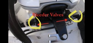

You any pics of the steering set up at the engines AD ? Show me the rig there, the size of the supply pipes and the pump at the helm hub. Did they supply you with the bleed and fill kit it would have came with originally?

There are manual bleeding valves on that too AD. Almost certain of it. Sometimes all of the air doesn’t self bleed back to tank and it’s required. Only ever seen one system like this and never worked on one, but I’m almost sure of that much. Have a look at the hydraulic cylinder block itself. There is probably manual bleed valves. May not be the issue, but certainly worth doing a manual vent or bleed process, I’d think. Can’t do any harm.

This is different then the typical hydraulic steering your thinking about. It's self bleeding and not the issue currently
Just had a look through that video. Paused and took a screen shot. Put some wee yellow circles around the manual bleed vent valves. I think depending on where the reservoir is and the chance of it fighting against the other perhaps, there might be a chance of you maybe having to manually give it a go. Leave it with you and see what you think anyway. Here is a picture if it helps any. Best of luck either way. Hope you get it sorted.

Air is not my problem
Understood AD. Hope you get it sorted. It was the mention of the wheel being able to be rotated after full lock on the engines steering that perhaps had me that way inclined. Presumably a relief valve must be doing that. Anyway. Don’t know anything about that particular system. I’m sure a man of your ability will have it sorted out soon enough. How are you getting on with her so far anyway ? Are you since converted to a 4 stroke outboard man perhaps ? How’s the performance and fuel use, compared to the lovely boat you had previously? Can I ask what props you run on her too ?
