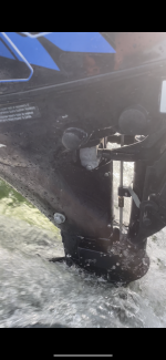

To start with, is the newly acquired prop a 3 blade Tohtsu OEM one ? With motor trimed at 90 deg, deck load well distributed, when at plane (full throttle) on flat calm water cond at which lower leg height is the water flow pasing by ? is it passing right under the small upper plate or over the lower AV plate, need to pull head out transom to check that....
To take the max out of any Tohatsu motor will need to rev towards its max wot rpm range factory stated as loaded, this is the ideal motor height for Tohatsu OB's...

So I got out yesterday for some test runs. I did note that the water level is running about 1/2 below the upper plate just like the above photo shows

You said that the water flow is passing around 1/2 below the upper plate, in post 2 the water flow is skimming right under it, is it possible to lower the motor a tad via the jack plate or with removed jack plate for motor to sit on middle transom for the water flow to match post 2 pic ? Once there with the motor revving at near its max wot rpm range of 6 K, the combo will plane slight faster than now on flat calm water cond when at full throttle from a dead stop. Remove your current doel fin and use it as a paperweight or book stand LOL!!
