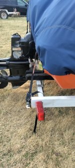

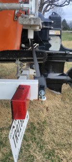

Note that the only thing contacting the back keel roller is the outdrive. Also note that the winch stand is very rusty... and is also ballooned, likely from water freezing after a noted "left in the rain for 6 weeks at a marina" incident 14 years ago. I wonder with a new winch stand/mount the roller contact point could be moved back to get the bunk ends and keel roller closer to the transom of the boat?
Reasons for wanting the change this is partially to make trailering/launching a bit easier (no need to dip the trailer as far), but also as a structural improvement (less stress on bunks) and to allow for full travel of the outdrive without bashing the keel roller.
