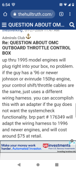

Oooops

Before you chop up your harness, Look to see If CDI electronics makes an adaptor.

I believe I found the adapter.

This should be the info your looking for. Learned a few things myself.

Yes, as a bush fix you could just splice. I thought it helpful information that it could be done and how to match up. Let us know if it works.
