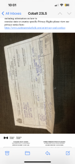

Thank you kindly Sir. I called again. I have the serial number where would I be able to input it and find out if it has a 454mag or not. I asked the seller he said if that’s an option that they chose the “biggest engine” available. Pics attached of serial number.

Very good information thank you. Ah. Wish it had the mag. Less work for me. From research I see don’t even bother hopping up the 7.4L and just save for a 502. Any chance anyone can look at the serial number and know where to call or input it to decode?
EDIT*** Upon research all above posts are right. It doesn’t say 454MAG just 7.4L MPI. Oh well. Guess I’ll save for a 502. Or trade it for one next summer.

I never understood what the LX signified . . .
The 7.4L engines 'shine' coming up on plane . . . probably better than the 454 MAG, since those engines are more suited for the top end of the RPM range.

I spoke with Cobalt boats. Apparently it’s just a different intake manifold… and exhaust so they say. But this one is indeed a 7.4LX MPI Bravo 1. Thank you all for the help. If anyone else does have any info on an LX as opposed to regular 7.4L
