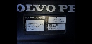

44,097
Serial number comes back as Gi-G
Fuel pressure low side 8 psi +/- 4 , high side 50 to 60 psi
