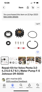

Hi. I was still sitting in water. Yes, I lubricated the impeller before installing it. Not sure on my leg model but the attached image is from the manual I received with the boat. It runs a duo prop.

What is the part number of the GLM impeller? Hopefully 89623.
3862567
21213660
Replaced by
21951348
If it is 89623 then you're possibly dealing with a defective, wrong type/size, not spinning type impeller issue or you have air in the line between the drive to the impeller housing. You may have to manually help prime the water up to the housing better/more to make this easier and not hurt the new impeller if it's the correct one, etc..
