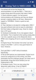

I came across this info last night when researching, it was back a few years.
