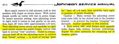

the gap itself is not all that critical... was is critical is to OPEN at TDC. test with condenser disconnected !!!
I believe Gale is cousins of E/J outboards so the timing tool would help you work on the " gap"
(look at it as a skinny flywheel to duplicate the FW's marks ......allowing easy access to the points for proper ajustement)
this video may help give you the concept. " Gale experts" can chime in
  • Timing pointy tool method.pdf

99.9% of the Time, setting New Points @0.020" will get you the Correct Timing. Using a Flat Feeler Gauge on used Points, all bets are off, and the Timing Marks and a Continuity Meter/Light are a better choice
39,467
Correct.----You are timing the breaker point opening to get maximum spark intensity.----Actual gap does not matter.----Rest if the timing is looked after.----A simple concept much misunderstood.
39,467
The timing fixture is nothing but a --" dummy flywheel "---The flywheel on the motor can be used to time the breaker points.----Just takes a little longer.

ok thanks .. next time i'll reformat things under .ppt.
it is just 2 pages from the Johnson manual and I never had problem attaching them before but things change I guess...????
