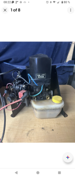

Could a pump like this one work with my old Mercury? Just have to find two hoses that will fit the connections.
15,093
They make that pump new on amazon, unsure of compatability and I I found exact matches for my 82 50hp on ebay, new. My pump uses four hoses.
15,093
Here is a slightly diff one. DB electric lists the oem part number it appears so you can cross reference that.
28,797
As far as I remember Mercury OB's used those two hose, pump-in-boat style for just a few years. The earlier PTT pumps were 4 hoses (out of the control valve) to the PTT cylinders, and the later (and current) PTT units were mounted between the transom clamps.
I do not know if the MerCruiser PTT pump will work, however. Hopefully someone who knows will chime in.
