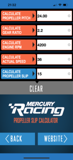

Some realistic and safe assumption figures for you Peter. Sensible margins I’d think, if you agree ?
24’s definitely a good starting point I’d think
