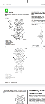

The odd hole goes over that channel I'm pointing at. Either on the top or bottom. Maybe it doesn't make a difference and that's why it doesn't really show in the manual.

Being that that hole is covered by the Retainer, I don't think it matters. FWIW, if the 1st pic were the Reeds that were in the engine, they looked from this angle, fine.
Don't forget to install new Locking Tab Washers, and use Locktite on the bolt as instructed in the Service Manual

I didn't know why up or down would make a difference but I never gave it a thought about it being under that retainer. Good observation. I'm gonna go with that. Yes, the old reeds were fine, but since I was in there and had the parts. Never hurts to have new parts. Thank you sir.
