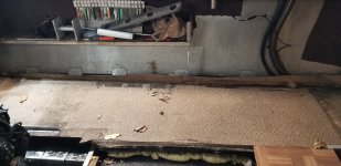

Thanks for responding I'm going to try and attach a picture it's a 1986 if that makes any difference to anyone it is the original deck. I have not been able to spot any screws or rivets but then as you can see I haven't removed or torn back the vinyl flooring that was put on at the factory am I to assume that there would be rivets and so on underneath of this and I need to remove it? Thanks for your help

Yep, should have rivets under the vinyl.
Many thanks, just wondering what the heck was going on I figured something was under there LOL I'll peel at back tomorrow and see what I got to deal with any ideas on getting that phone out of there? The bolt as a dry weight 13 and 1/2 when we took it to the scale after it wouldn't come up on plane, it weighed in with kicker motor 10 gallons of fuel in the boat at 3,400 lb so we figured that. Original foam was saturated any ideas?
