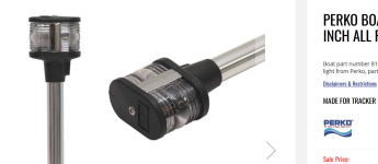

the OP's light is just an aluminum tube transom light from Perko
plenty out there up to 61" that should plug into his socket.

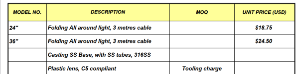

here is a 54" with a 3-pin base.
